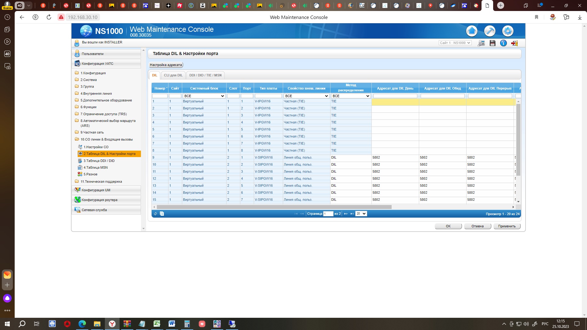

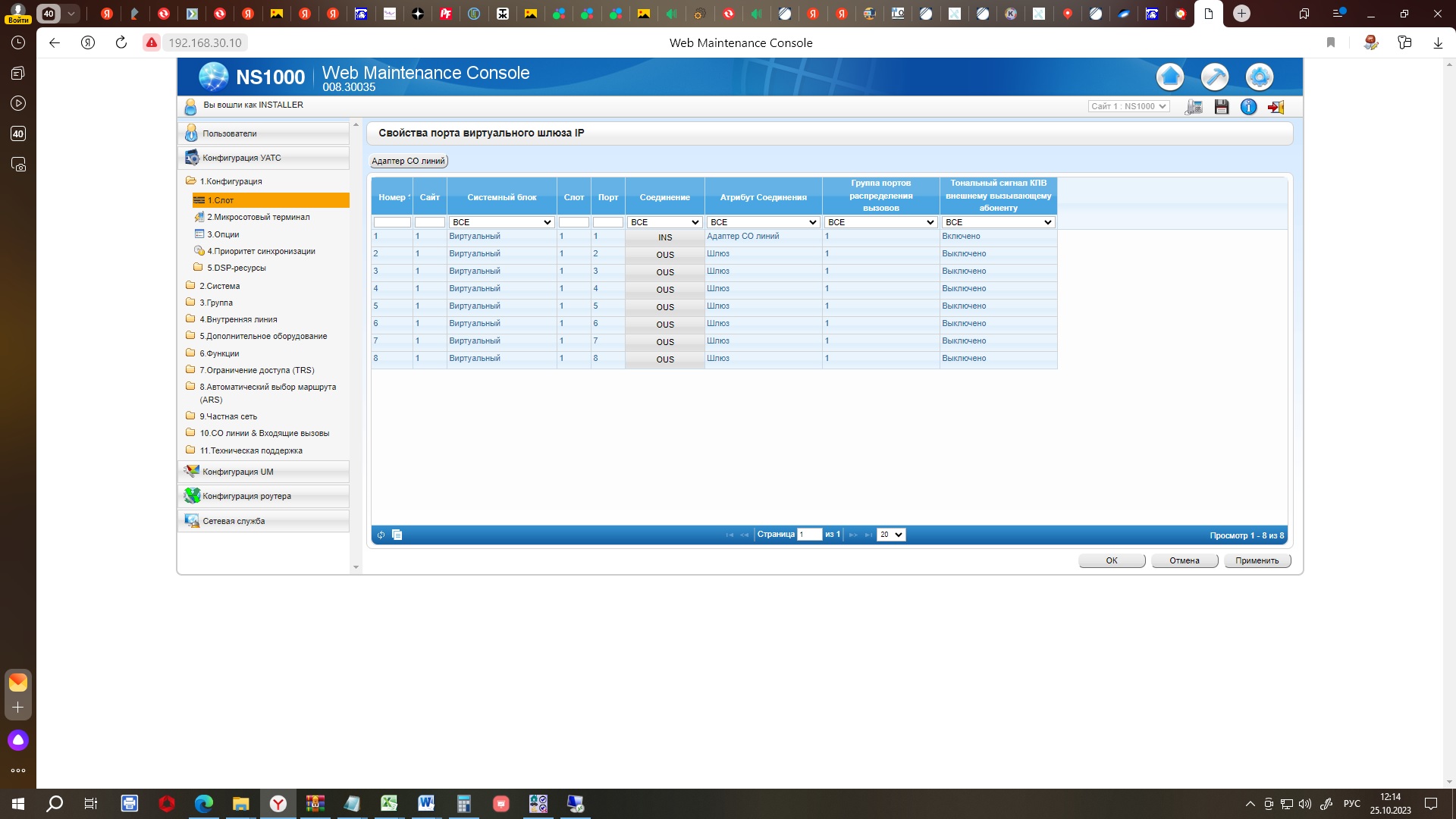

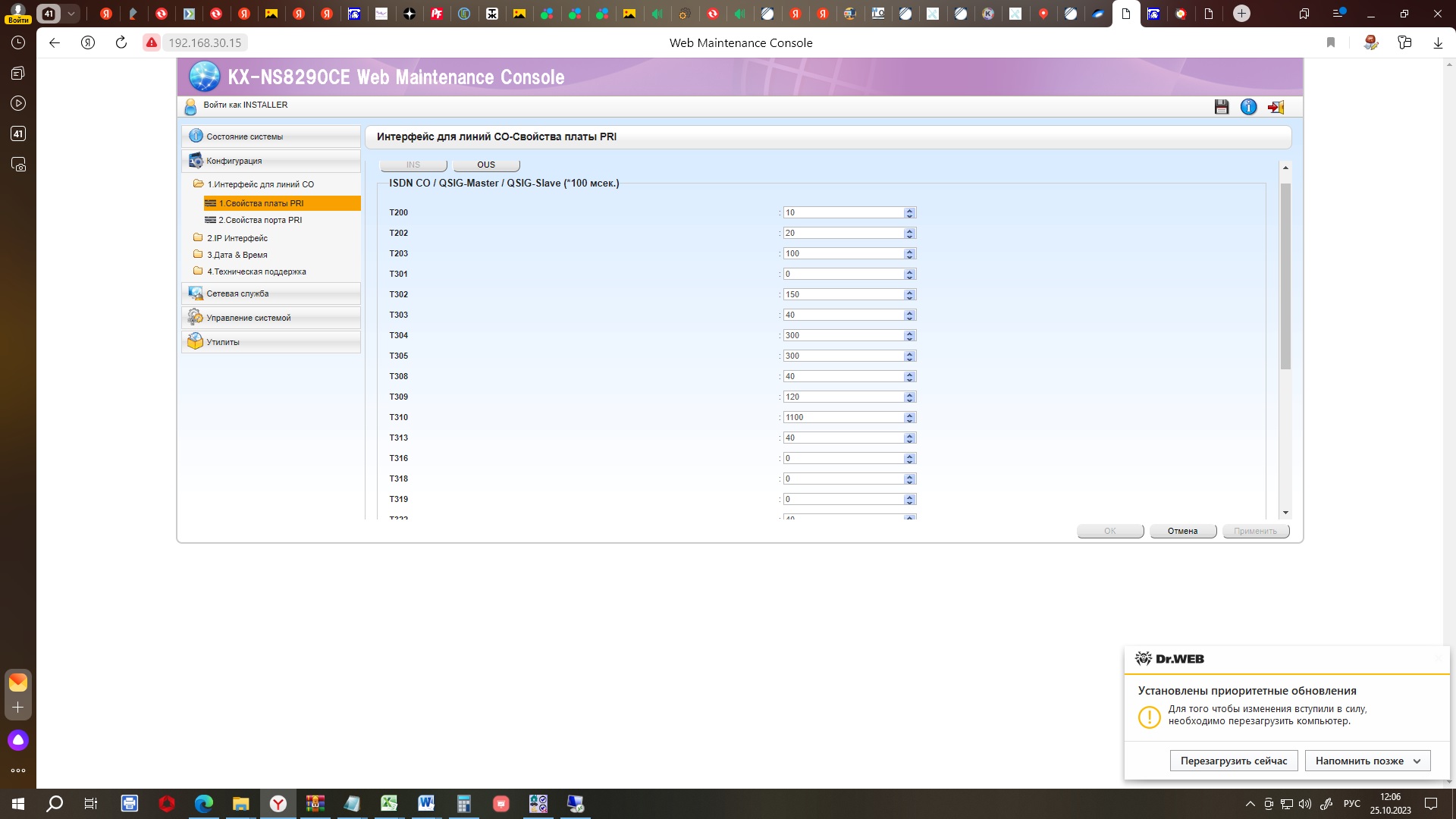

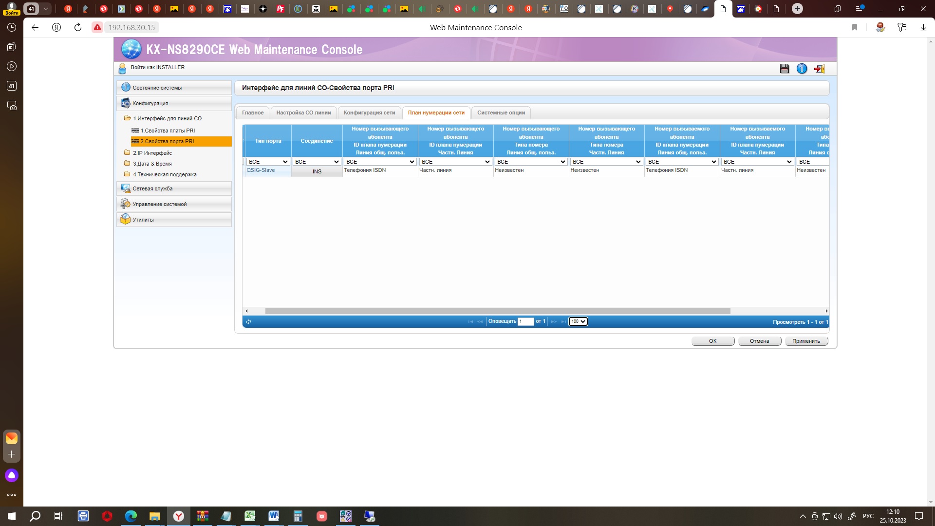

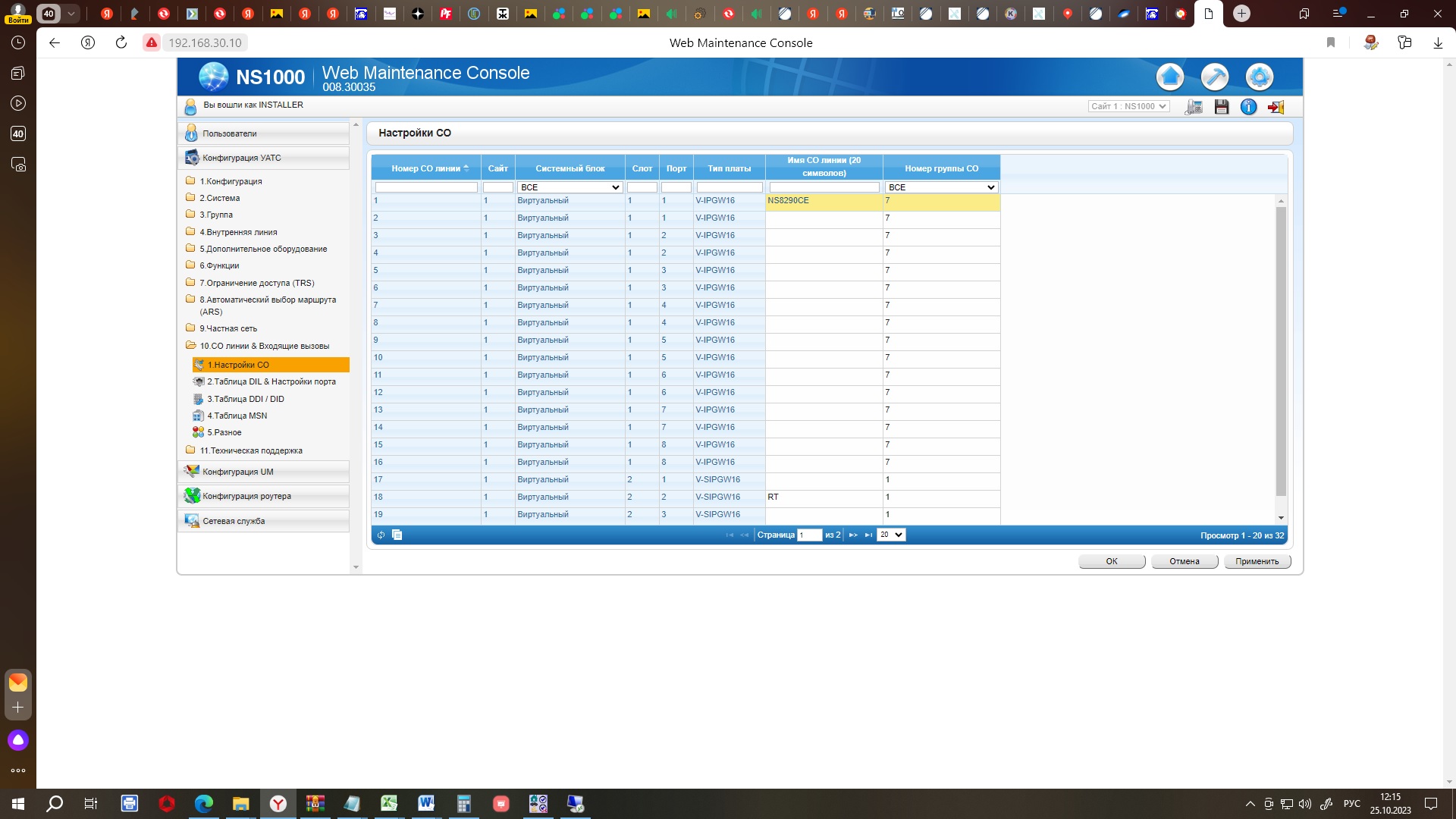

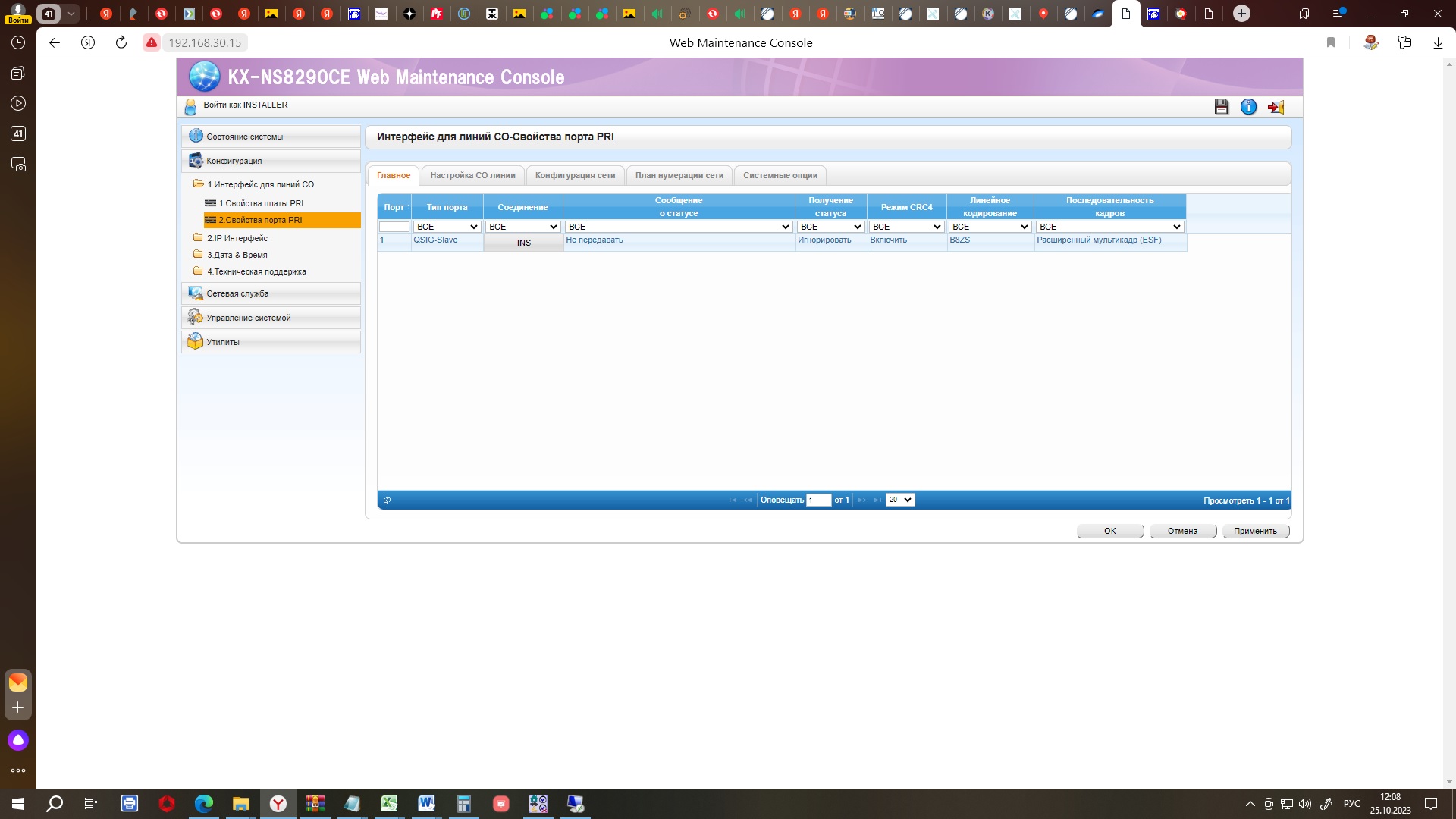

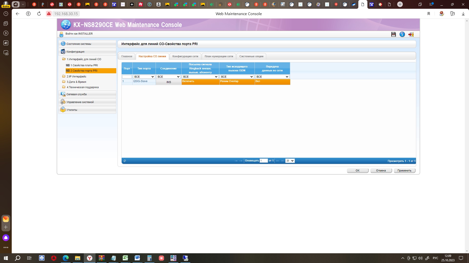

2023-10-25T09:20:38+00:00 2023-10-25T09:20:38+00:00 https://www.forumpbx.ru/viewtopic.php?p=9199#p9199 <![CDATA[HELP!!!!! NS-1000 с TD-500 через NS8290]]>
Трассировка
QSIG line->PBX No.948 Port:1 (elapsed time from LPR reset) 23/10/25 12:12:15
L2: I SAPI:0 TEI:0
L3:
SETUP crn:0149 (O)
Bearer Capability: 90 90 A3 (3.1kHz Audio A-Law)
Channel Identity: A9 83 81 (channel=B1 excl.)
Calling Party Number: F9 31 32 38 36
Type of Number= Reserved, Numbering Plan= Private
Number= 1286
Called Party Number: 89 31 35
Type of Number= Unknown, Numbering Plan= Private
Number= 15
02 01 7C 80 08 02 00 95 05 04 03 90 90 A3 18 03
A9 83 81 6C 05 F9 31 32 38 36 70 03 89 31 35
PBX->QSIG line No.949 Port:1 (elapsed time from LPR reset) 23/10/25 12:12:15
L2: I SAPI:0 TEI:0
L3:
SETUP ACK crn:0149 (D)
00 01 80 7E 08 02 80 95 0D 18 03 A9 83 81
QSIG line->PBX No.950 Port:1 (elapsed time from LPR reset) 23/10/25 12:12:15
L2: I SAPI:0 TEI:0
L3:
INFORMATION crn:0149 (O)
Called Party Number: 89 30
Number= 0
02 01 7E 82 08 02 00 95 7B 70 02 89 30
QSIG line->PBX No.951 Port:1 (elapsed time from LPR reset) 23/10/25 12:12:16
L2: I SAPI:0 TEI:0
L3:
Number= 1
02 01 80 82 08 02 00 95 7B 70 02 89 31
PBX->QSIG line No.952 Port:1 (elapsed time from LPR reset) 23/10/25 12:12:21
L2: I SAPI:0 TEI:0
L3:
CALL PROCEEDING crn:0149 (D)
00 01 82 82 08 02 80 95 02
PBX->QSIG line No.953 Port:1 (elapsed time from LPR reset) 23/10/25 12:12:25
L2: I SAPI:0 TEI:0
L3:
DISCONNECT crn:0149 (D)
Cause: 81 9B
Cause Value= "#27 Destination out of order"
Location= "private network serving the local user"
00 01 84 82 08 02 80 95 45 08 02 81 9B
QSIG line->PBX No.954 Port:1 (elapsed time from LPR reset) 23/10/25 12:12:29
L2: I SAPI:0 TEI:0
L3:
RELEASE crn:0149 (O)
Cause: 81 9B
02 01 82 86 08 02 00 95 4D 08 02 81 9B
PBX->QSIG line No.955 Port:1 (elapsed time from LPR reset) 23/10/25 12:12:29
L2: I SAPI:0 TEI:0
L3:
RELEASE COMPLETE crn:0149 (D)
00 01 86 84 08 02 80 95 5A
Статистика: Добавлено Andrey — 25 окт 2023, 09:20
